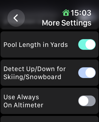

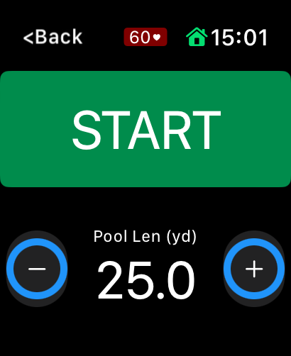

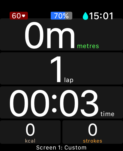

Trying to get WOD on my AWU2 to show pool swim distance in yards. In More Settings, I've set Pool Length in Yards, and have the start screen set to 25 yd pool length, but after pressing Start, the display shows distance in meters - screen shots below. What am I missing? Thanks.
Sorry, you can't show pool length in yards. The app allows to to specify the length in yards because that is how some pools are physically measured, but swimming distances are always shown in metres.
