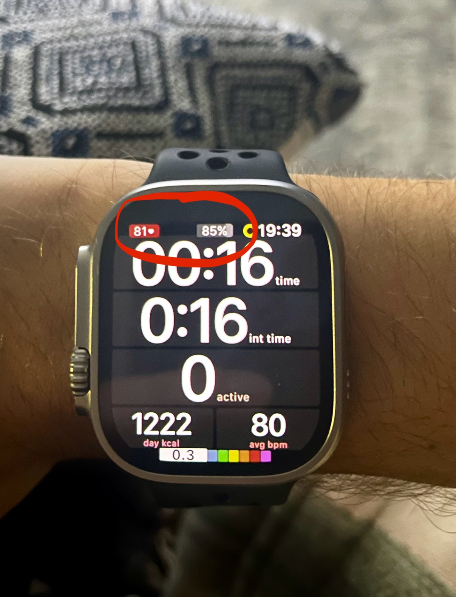

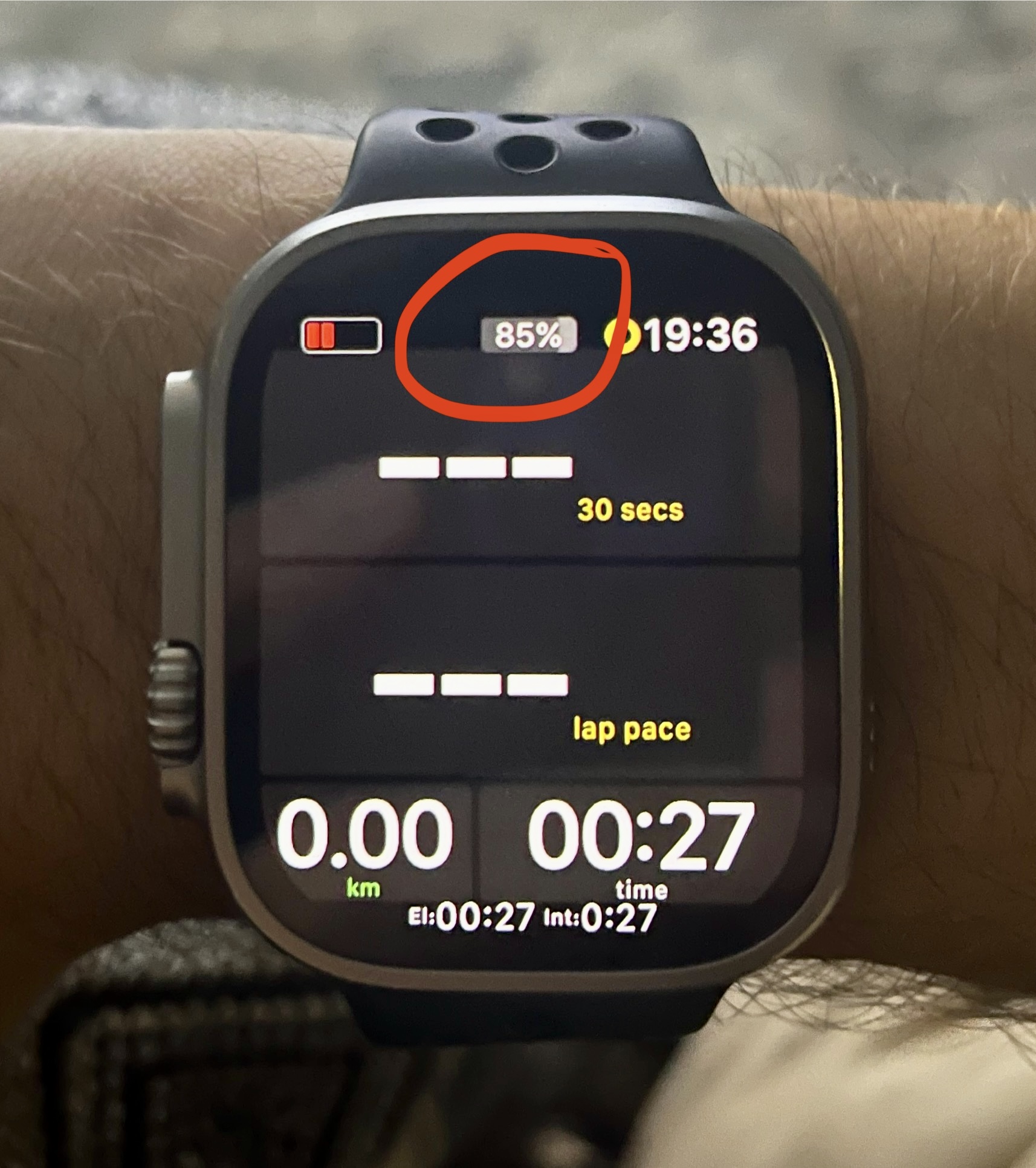

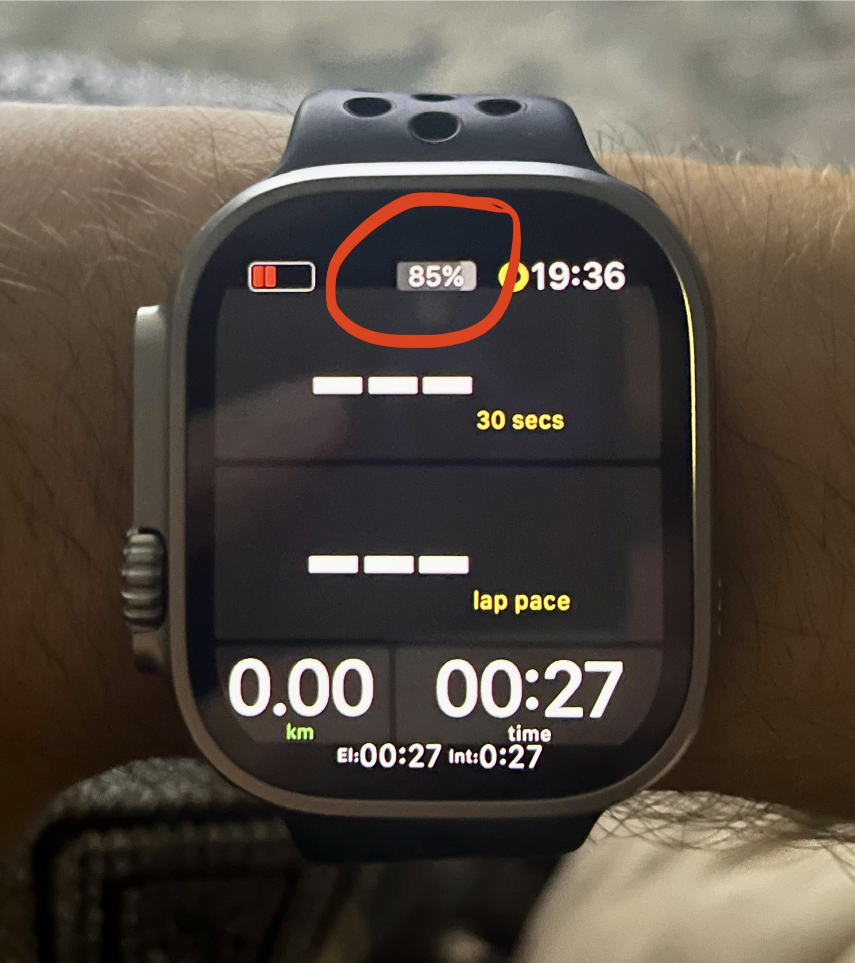

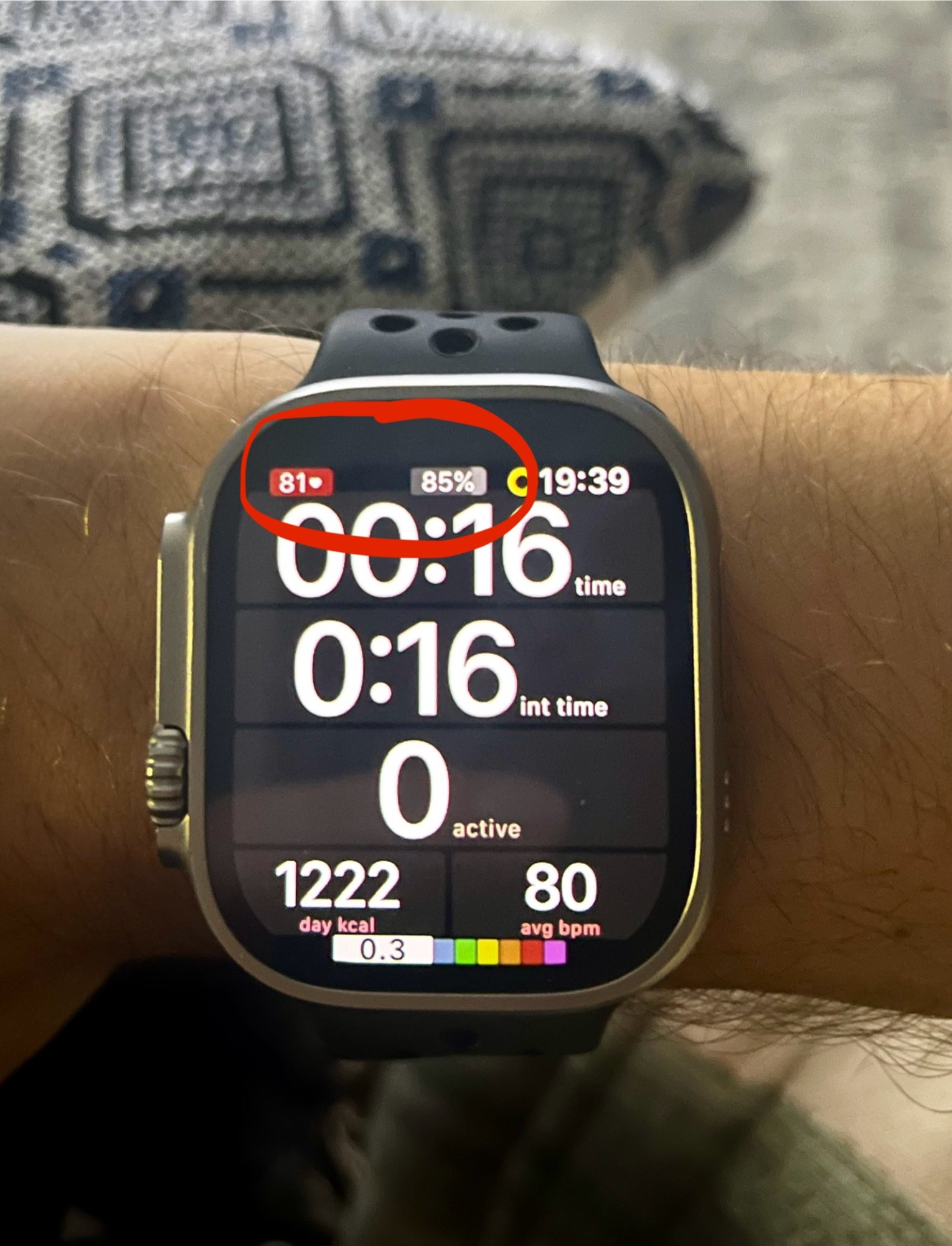

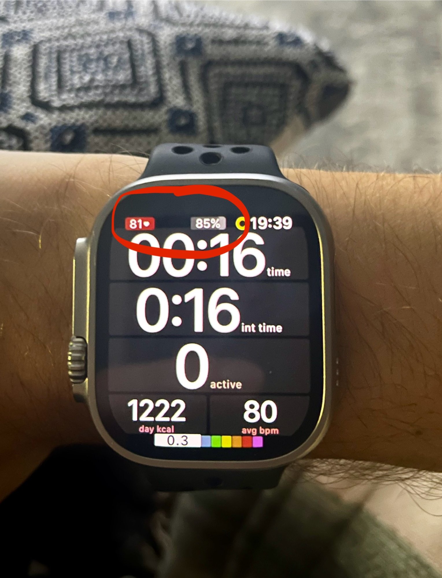

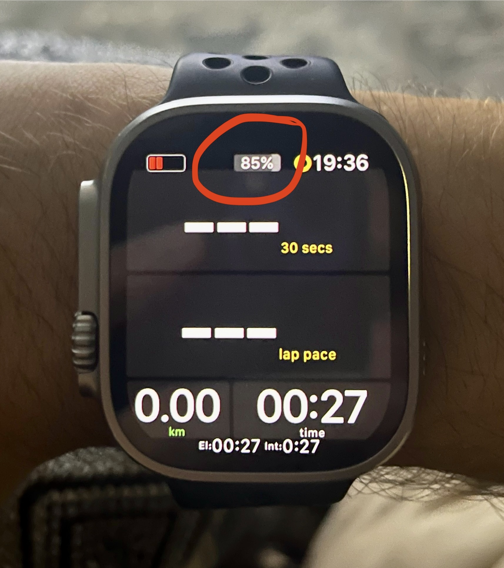

Hi! When I’m on weight training profile, the app shows heart rate on top of the screen with battery percentage on all screens. But when I’m on running profile, it shows a GPS bar and also the battery percentage. Is it possible to change this? While running I would like to change any of the options to heart rate too.
Sorry that is not possible at the moment. The app shows GPS and battery for outdoor workouts and HR and battery for indoor workouts. I don't think anyone has asked for that before but it seems a good idea so I will bear it in mind in the future.
Thanks! As we already have the option to customize the bottom bar, it would be nice been able to change the top one too.
