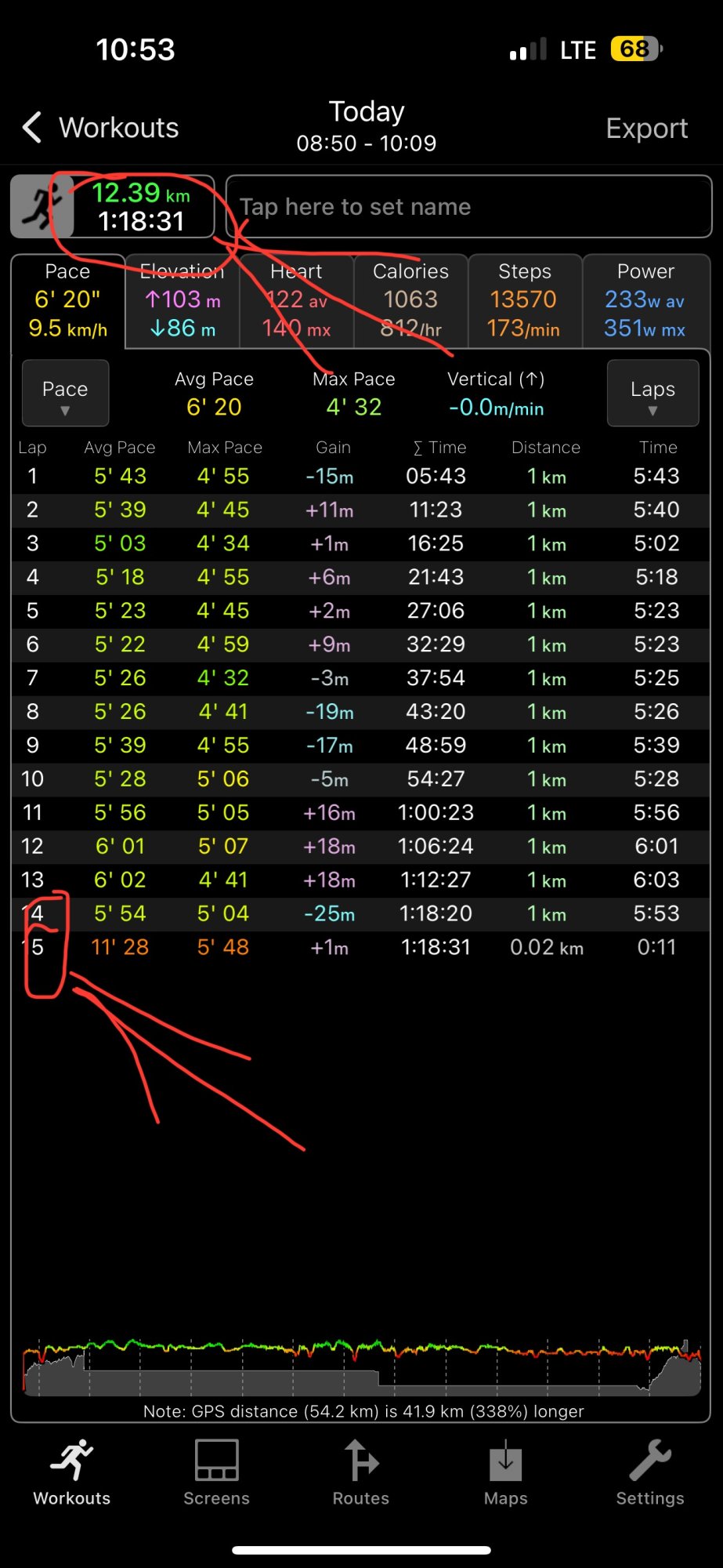

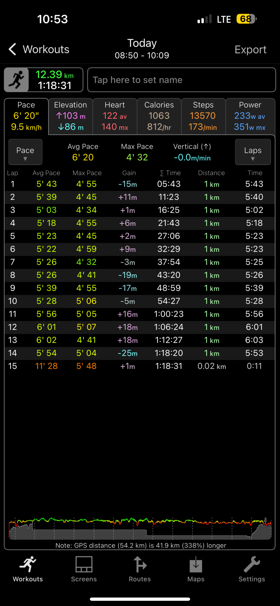

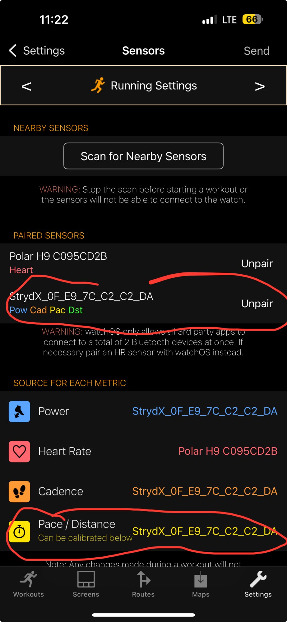

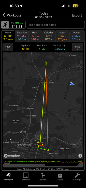

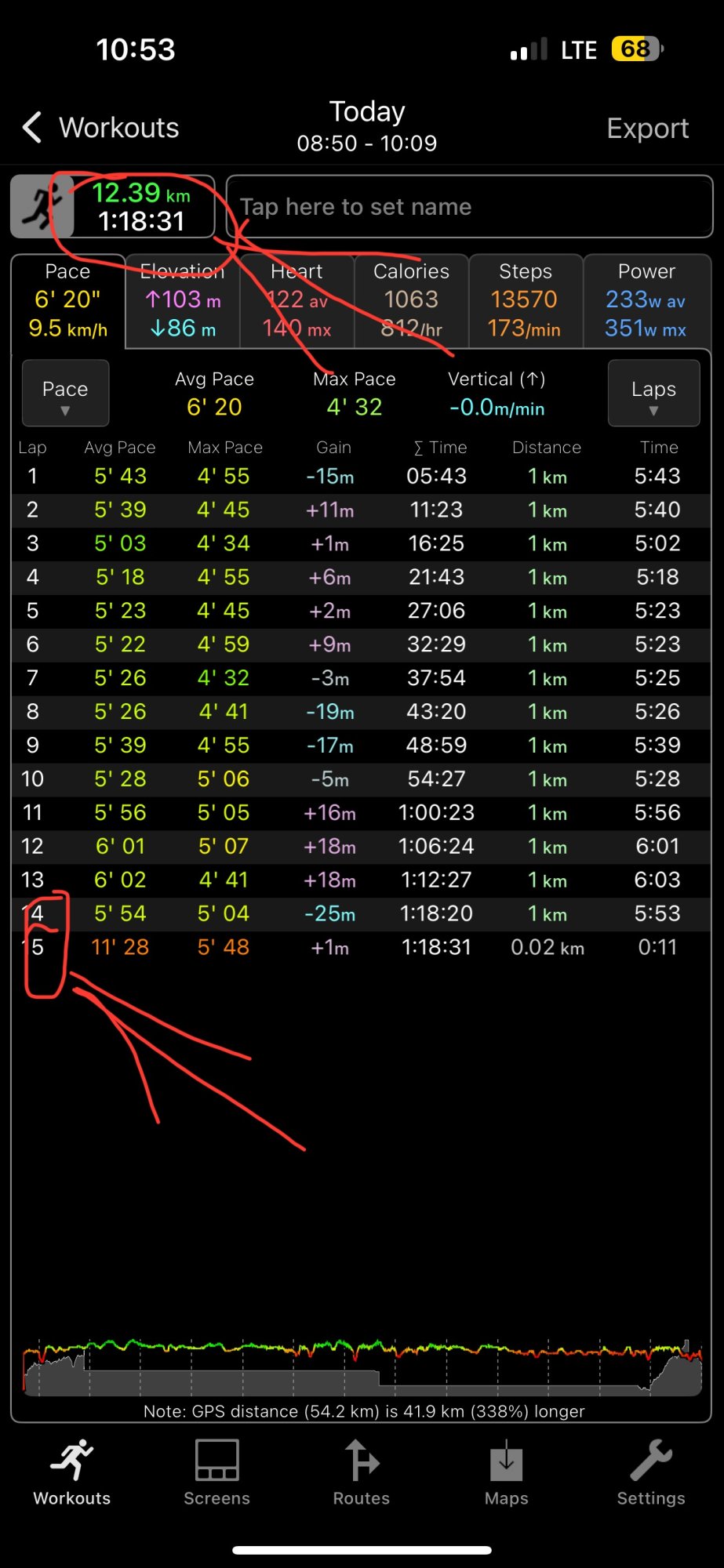

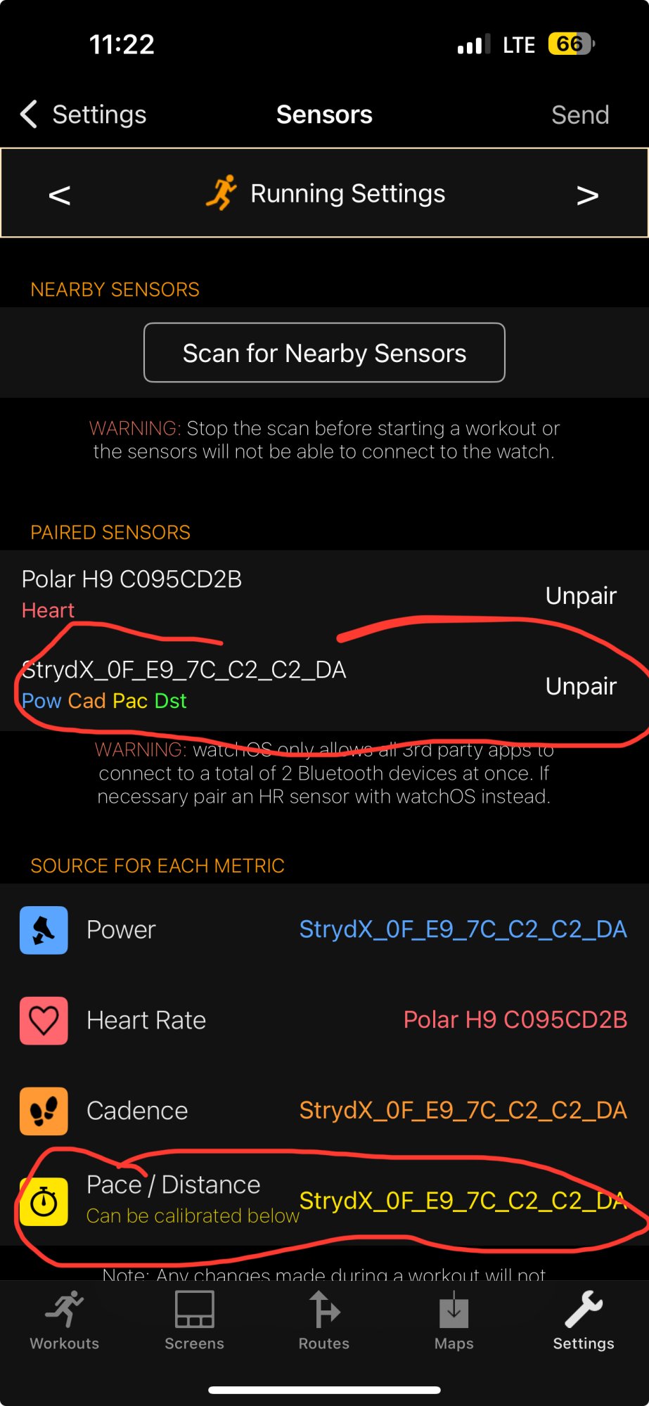

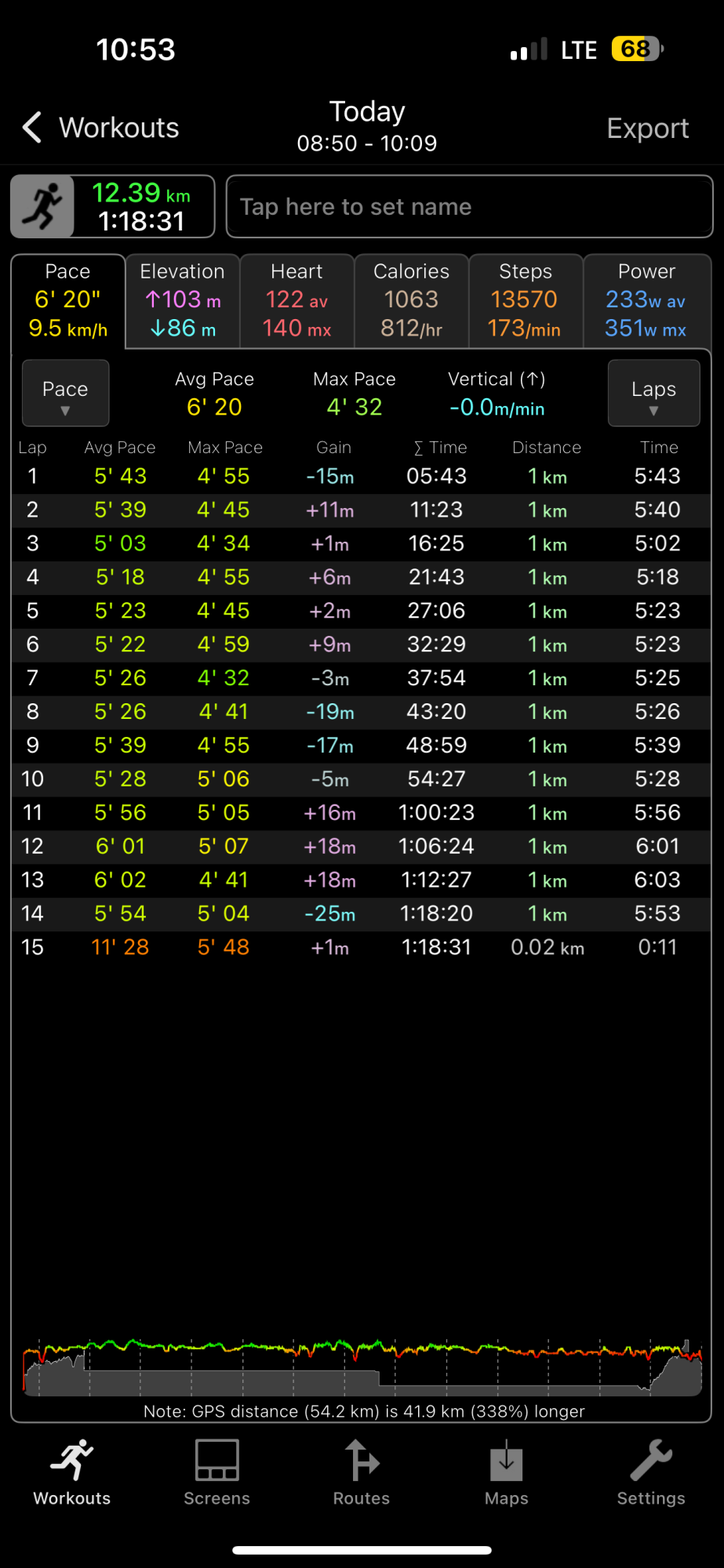

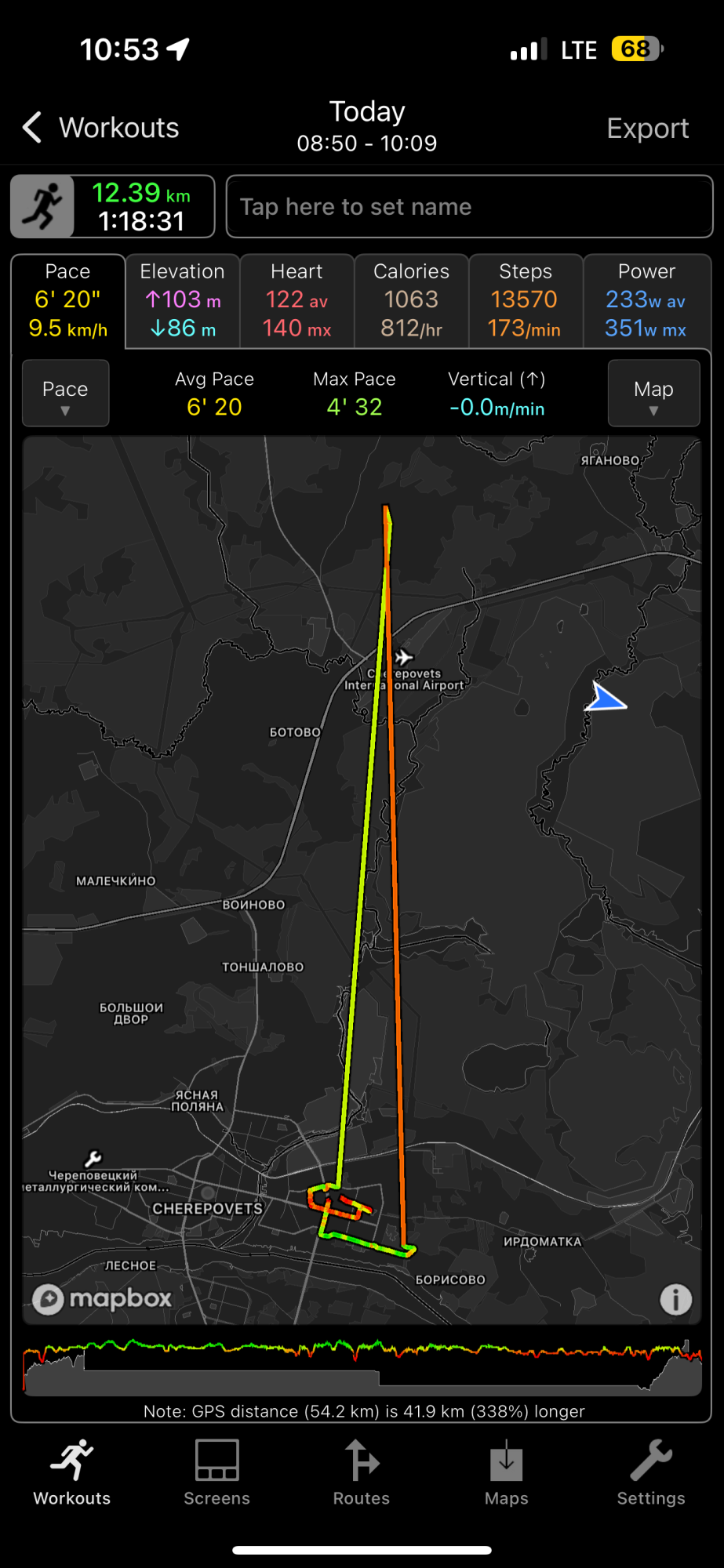

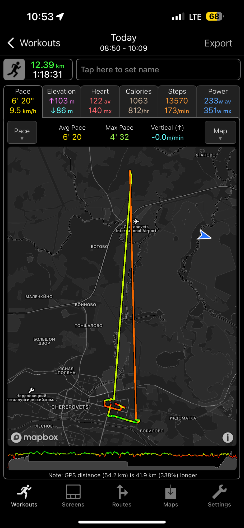

Hello everyone! @cfc How to recalculate the distance from the sensor Stryd. After all, during training, the distance and pace are reproduced from the sensor, and after training, the GPS recalculates.Laps=km
I ran 14km, finished the training, and shows 12km after the recalculation.
There is definitely something strange going on there judging from the straight line in the middle screenshot.
Please could you send the wkt file for that workout to info@workoutdoors.net and I will take a look. To do this tap the Export button 3 times quickly.

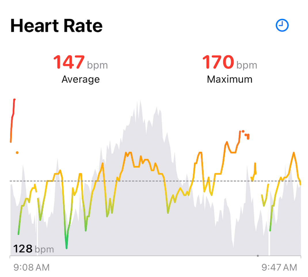

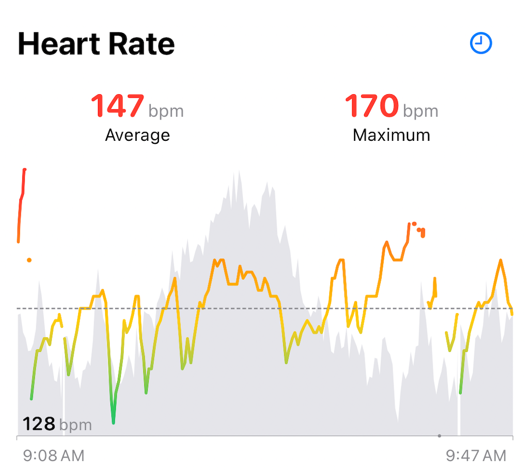

Unsure if this has been reported, but for awhile now all my workouts start with my heart rate as a weirdly high level, and it takes 10-20 seconds for WorkOutdoors to correct to the actual heart rate. This does not appear to be a bug with the OS or sensor locking down as checking the heart rate app shows the correct value right before I start.
The watch can take a while to get a reading but that is usually overcome by showing the start screen with the HR so you can wait for a reading. Are you sure the heart rate is showing the correct value before you start? If so then I don't know what is happening. Sorry.
If it hasn't gotten a lock yet it should report nothing rather than an erroneously high heart rate. Having that value blanked out at the start of the run was the prior behavior and it's perfectly fine/expected. It was so jarring the first time this happened that I thought I was having a heart attack.
Going through logs, it seems like it started on Dec 25th and has happened on every run since. Don't recall seeing this issue before, and haven't altered the way I used the app or watch. Also confirmed it's not the watch/sensor by seeing the expected value in the HR app at the beginning of several runs while this high HR reading is happening in WorkOutdoors.
Is there a way to get logs to you to investigate?

If it hasn't gotten a lock yet it should report nothing rather than an erroneously high heart rate. Having that value blanked out at the start of the run was the prior behavior I noticed and it's perfectly fine/expected. It was so jarring the first time this happened that I thought I was having a heart attack.
Going through logs, it seems like it started happening on Dec 25th and appears to have happened on every run since. I don't recall seeing this issue before, and haven't altered the way I used the app or watch.
I've confirmed it's not the watch/sensor as I validated my HR is reporting correctly in the HR app at the beginning of several runs while this high HR reading is happening in WorkOutdoors.
The latest version of the app is much older than that. Please could you send me wkt files for a workout before the 25th December and a workout with the problem. I can then see if you are using different versions of the app or of watchOS.
