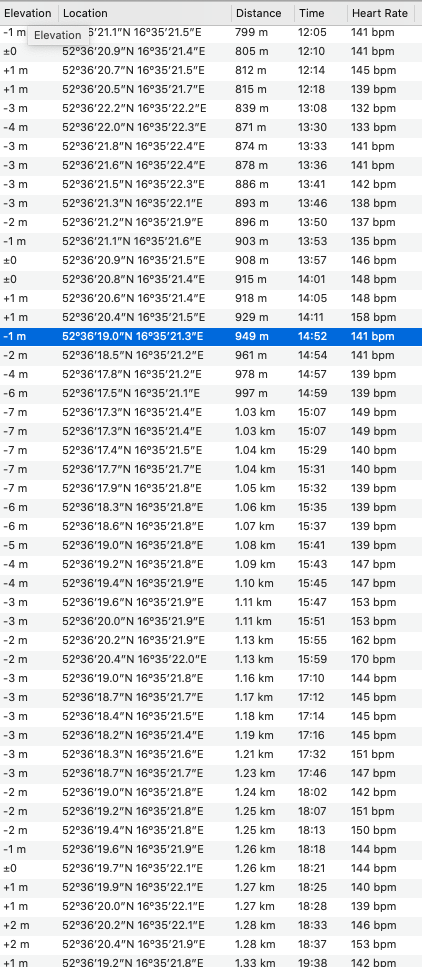

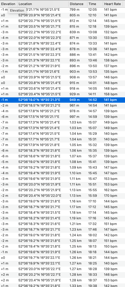

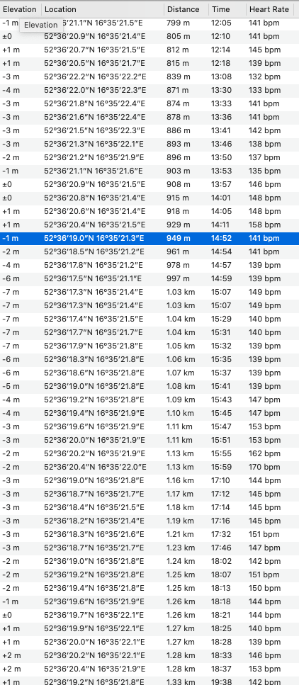

Yesterday I was sledding with my son on a ~15 m artificial hill and I've notice something. I had a Hike started and all was great on the watch but in WOD and also in an exported file a lot off data is missing. Single sampling points are sometimes 40 sec apart! (attachment, time column) That causes sometimes a 30 m jumps in the track. I've noticed, that the same thing occurs on other activities when I'm not moving while resting, on traffic lights etc. WOD is just not saving them and every activity is missing HR data because I'm not moving. I know this isn't an AW limitation, because sessions from the stock app are always 1 sample per sec (not counting auto and manual pause).
Is there a way to set WOD to always save a 1 sec/sample?
Hi there!
The app should generate a point every couple of seconds if you are static and every second if you are moving quickly. Please send the "wkt" file to info@workoutdoors.net and I will take a look. To do this tap the Export button 3 times quickly.
