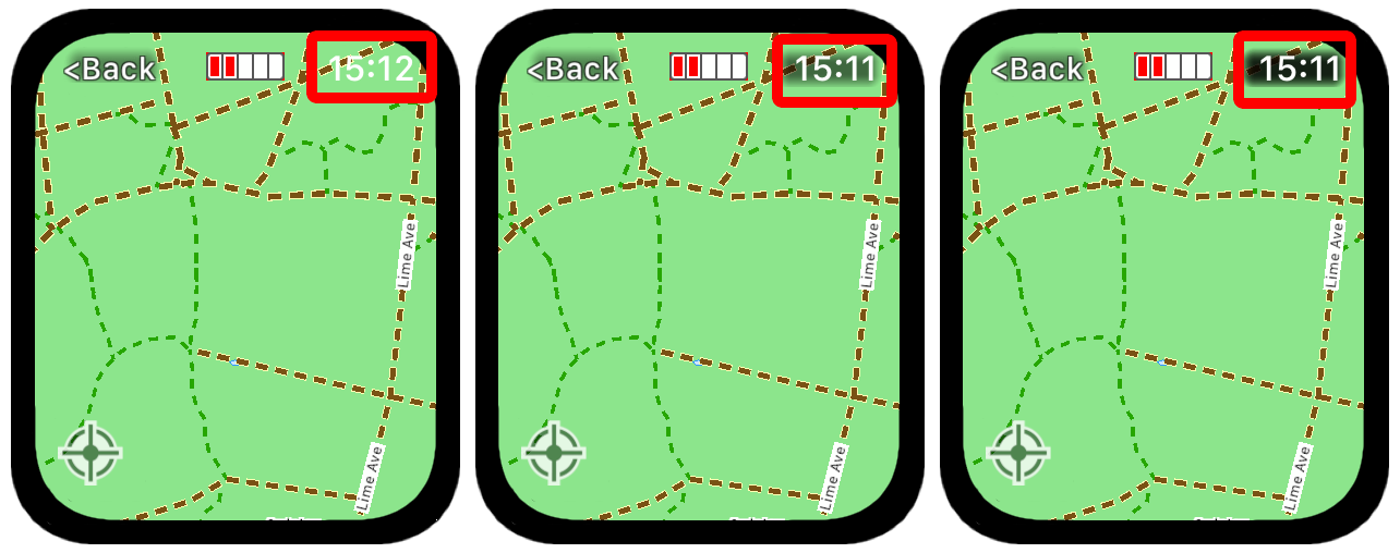

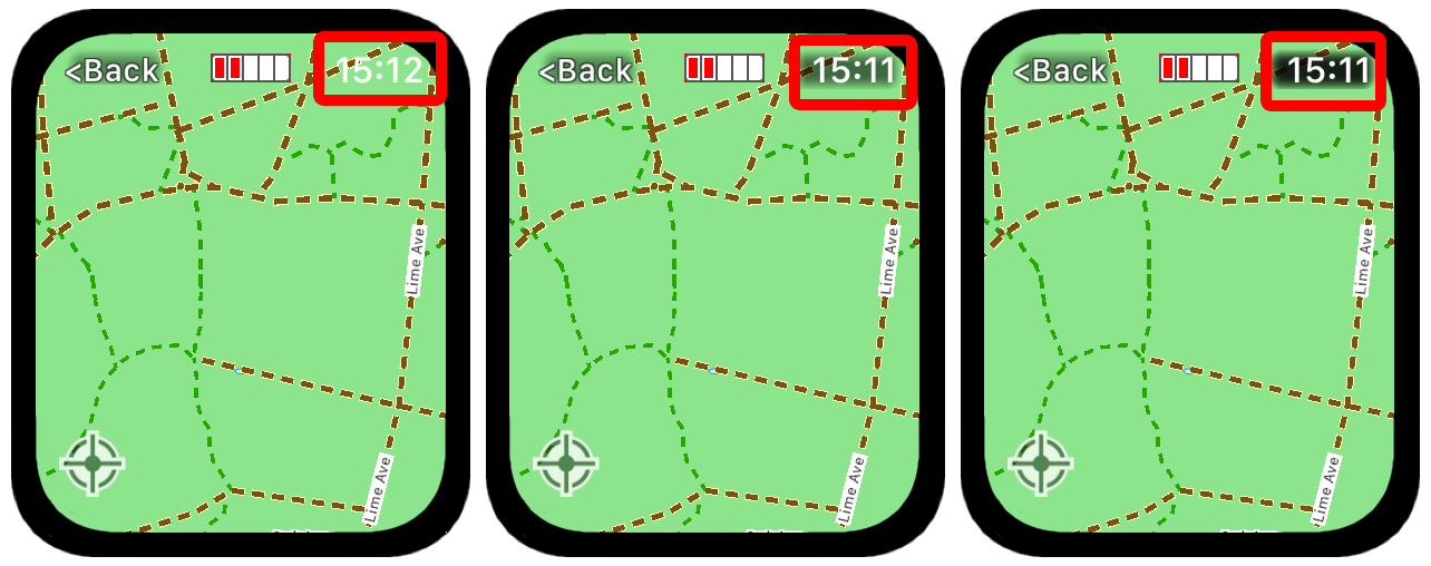

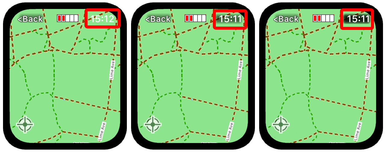

Here are some screenshots showing the difference between each background for the time: None / Grey / Black:
Yes, i have selected the send option. No matter the option the background is always similar with the middle one. I have the latest update installed.
Please try changing it in the watch app. To do that go to the Settings and tap Map and then it should be available as an option near the bottom. If you cannot see it then you may not have the latest version of the watch app. It seems that Apple sometimes does not update the watch app when you update the iPhone app.
To check this go to the Settings on the watch and tap More and then scroll down to the bottom where it shows a version number. If it does not show 4.3.6 then you need to update the watch app. The best way to do this is to go to the App Store app on the watch and use that. I hope that helps!
The watch was not in the latest version. I have updated and now works as you described. It ok using the black background. Many thanks 🙂
