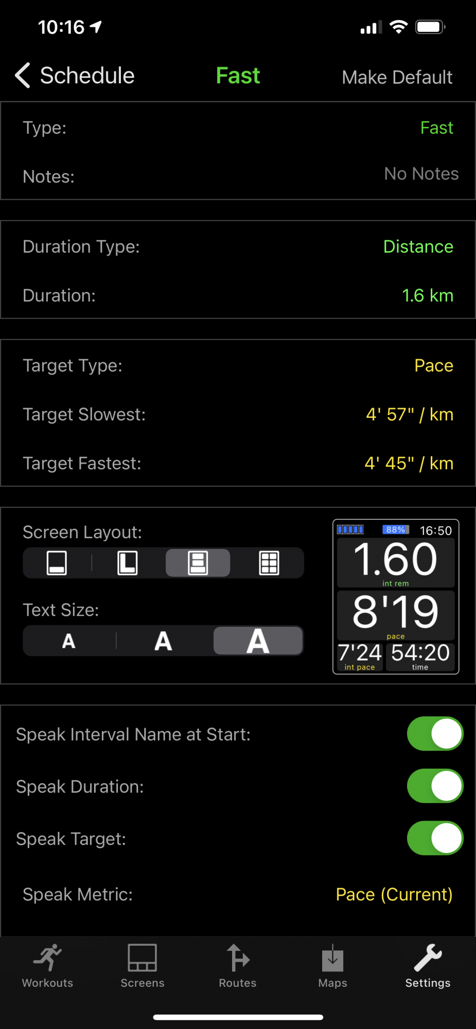

I'm getting back into running intervals, obviously using Workoutdoors. I tried 6 x 1.6km intervals last evening and have a few questions!
I see I can choose what to use for Current Pace from Pedometer, GPS or Apple Health. Is there one that will give the truest results when running outside?
I think from the interval screen (below) then the 2nd line is the actual pace, and the int pace (bottom left) is the average for that interval? Is that correct? Sometimes the actual pace would jump quickly after a hill for example (I guess this is related to question 1 above)

The best option for current pace when running is the pedometer. In your screenshot you are correct that the second line is the current pace and the bottom left is the average for the interval so far.
