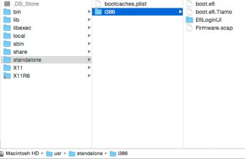

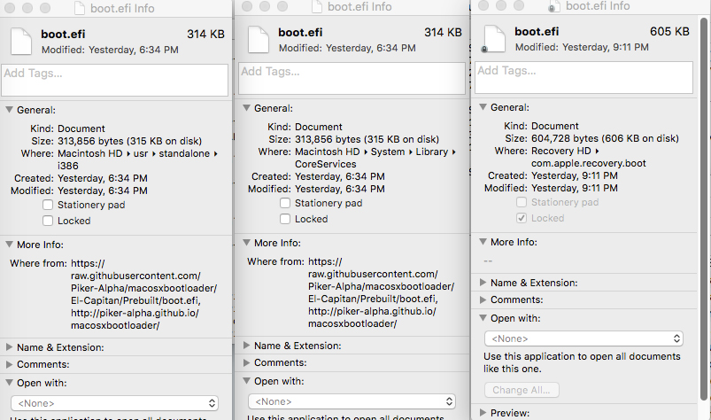

Okay, I never really considered myself a noob until now...
The two boot files (i368 & CoreServices) seem to be identical and correct. The third, Recovery HD is 605kb(!?) - see attached. The thing is, I could have sworn that I replaced ALL three with the EXACT same file! The other curious thing is; the Recovery HD is the only one of the three that actually works.

1) I had a Tiamo boot in the i368 file before I started the process that I was suspicious about (see attached). It's no longer there.

Looks to me like you have misidentified your machine or are still not connected with what you have done wrong
You may have a 3,1 Mac Pro, doesn't make sense that your recovery would boot with 64bit EFI and your main install would NOT boot with 32 bit EFI. This would indicate that you have a 64bit machine
Or, you need to remove the boot up Tiamo thing, I don't recall exactly where the startup item is located.
It has a startup launcher somewhere, as well as supply the boot up EFI. But the things you are typing don't make any sense, please further evaluate your situation.
BTW, the one in the usr folder should be locked.

With the original boot.efi (605 KB) I can boot from this disk on my 2009 mini. With the modified boot.efi (314 KB) I cannot boot on the Mac Pro. I have replaced the boot.efi in System/Library/CoreServices and /usr/standalone/i386, and the Recovery HD. All 3 are the correct file. I'm still not sure I want to clean install El Cap on this disk (would it even work?), I'd have so many apps to reinstall. This is really pissing me off since I started this installation yesterday morning.
