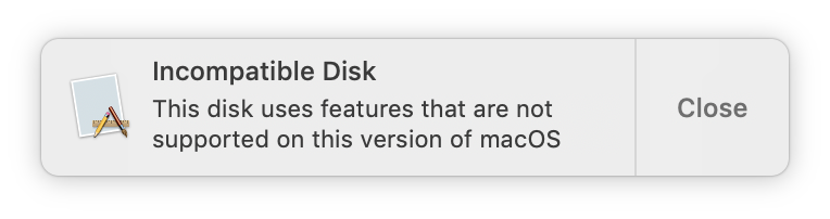

Booting back from my main external system drive, I got this:

There seems to be a partition in big sur hdd that is called "Update".
Maybe this refers to it?

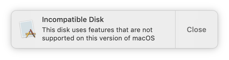

Booting back from my main external system drive, I got this:View attachment 1028096
I still haven't updated the security updates after v.2, sine I want to do full clone of the main drive and haven't had time to do that.
If you read the previous posts, you ought to install Big Sur on an external disk, which you would erase again anyway since the goal is to just update the T2 controller firmware. The APFS filesystem has been updated with Catalina and again with Big Sur, and is not compatible with Mojave. Hence the "install on external" mantra.
If you get this error you either did install Big Sur against all wisdom on your main external drive and will probably have to erase the drive & clone from your system backup, or you accidentially booted from the external Big Sur partition.
And if neither is true, reboot, and zap the PRAM. If the problem persists, boot into Recovery mode and check the partitions of your main system disk to see if and what the Big Sur installer might have changed.
Nope, I didn't install bigSur beta on my main (ext) drive, I installed it on 80GB PATA drive, I found in my drawer.
My main (ext) system is Mojave and it's installed on a APFS drive.
Are you saying that Catalina and bigSur have newer version of APFS?
I could mount and read that bigSur beta install just fine.
There was just this strange "Update" partition in that 80GB drive.
Is there a command to check the APFS version that OS is using?

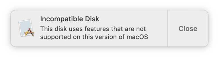

No idea if APFS is versioned. With Catalina came the dual container scheme ("data") for the system drive. And Big Sur seems to have introduced additional changes to APFS since Disk Utility on the Mojave Recovery partition just crashed when I wanted to check the external Big Sur disk.
I tested this also and run "First aid” to all: Media, container and both partitions. All were succesful and it did repair something small in the "Update" partition.
Incompatibility doesn't necessary have to be on file system level.
I still get that message after turning on the bigSur-beta-disk.
I tested this also and run "First aid to all: Media, container and both partitions. All were succesful and it did repair something small in the "Update" partition.
I meant this in a broader context, not on a low level, that APFS has changed. More on the organizational level i.e., how and where kernel boot files are stored, and partitions are formatted. Which I think is also the problem you're experiencing. The Mojave startup sequence either can't find all the assumed booter files on your Big Sur disk due to a new system layout, or does not understand the changed APFS formatting of the external Big Sur partition, and then complains with the incompatible warning message. Solution: just ignore and do not mount the Big Sur disk, or erase the entire thing 😉

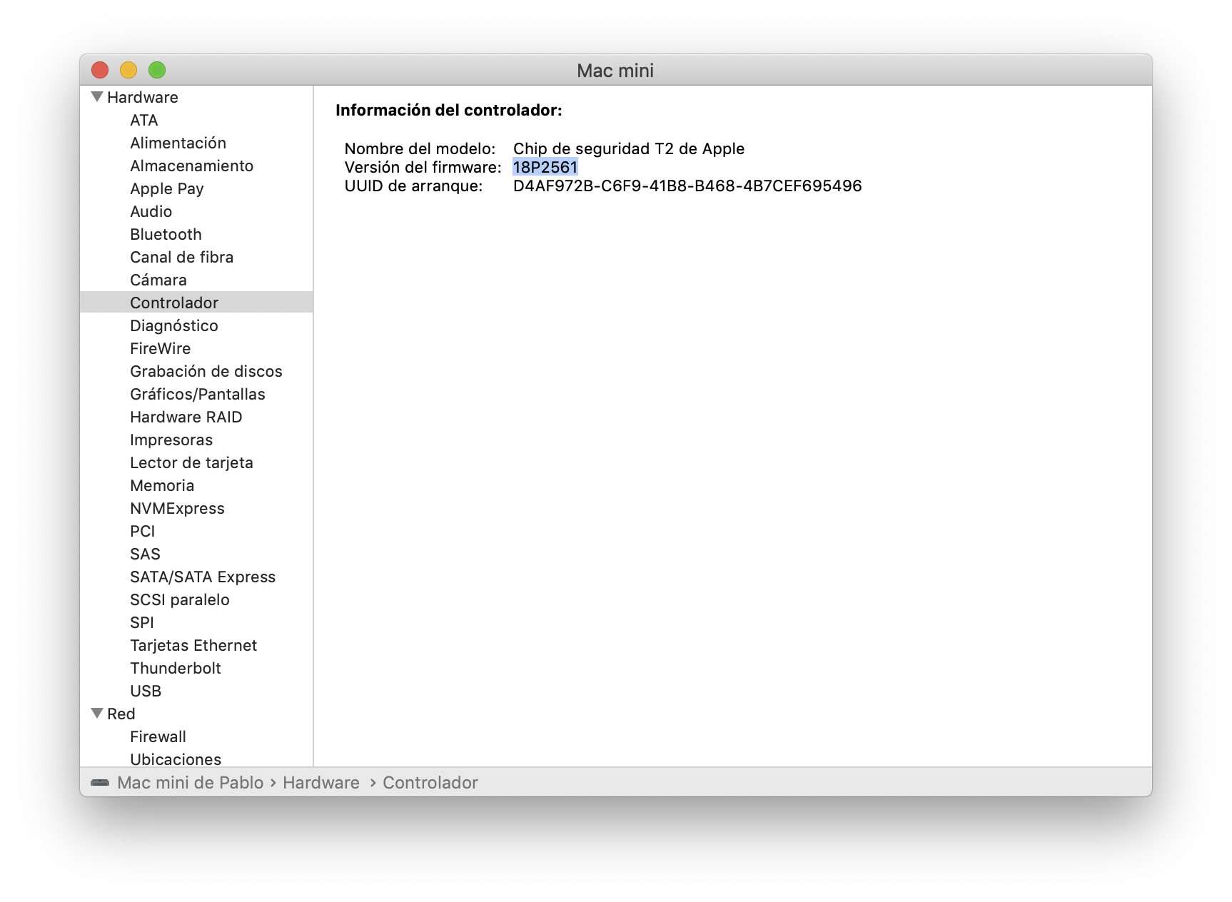

Hello everyone. I've been following this topic closely since the beginning of the year but wait until the final version of macOS 11 is released. I confirm that I install the system from an external pendrive prepared through the terminal as indicated by the Apple page on a partition of the ssd disk, and I update the T2 chip without problems, there are no problems with boot, rest, etc.
Also I delete the macOS 11 partition after the install and re added the free space to the Mojave partition. Works amazing and fast 🏎
