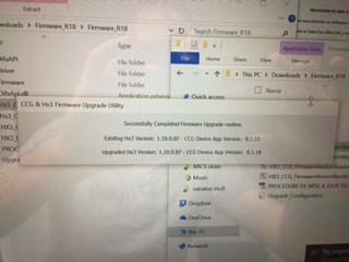

Read Sylvain-L post with excitement but this did not unfortunately work for me. perhaps i'm doing something wrong.
MBP 2017 Touch pad purchased last week.
Installed 64 bit version, was given message: "existing Hx3 version 1.10.0.B7 CCG Device App version 0.1.15"
then got "upgraded Hx3 Version: 1.10.B7 CCG Device App Version 0.1.18"
tried 3 different usb-c cables (the one that came with the MBP, the once that came with monitor, and this one, definately gen 2 https://www.amazon.com/gp/product/B01L0F6AJI/ref=oh_aui_detailpage_o01_s00?ie=UTF8&psc=1)
no power, no usb hub, no video, no audio.
What am I doing wrong?

You should use the driver that Sylvain-L posted on page 3. You will need a windows computer (you can't use virtual machine) and a good cable (can't say if just usb-c gen 2 is enough).

Updated the H277HU firmware successfully using the link Sylvain-L provided on page 3, (thanks for this!). Link below again.
It now works perfectly with the cable Acer provided.
To update I simply;
Used an amazon basics USB A to USB C cable (Gen 2). Unzipped the download on a W10 laptop. Attached the cable to the monitor. Ran the exe (note there are two 32 and 64 bit, choose your windows version). Update took minutes with no issue.
Link again here; https://drive.google.com/open?id=0B0WJLHzyWXyHdTJLVWdqNGMzdjg credit Sylvain-L.
