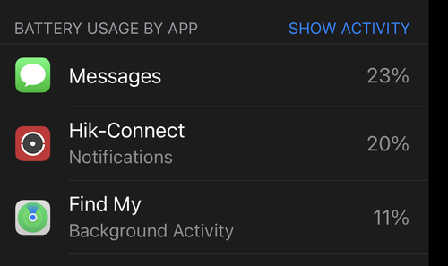

The results of the first 36 hours are promising. Find My Network is enabled
Here is 09:00-18:00 where i was at work (no dog)
18:00-10:00 so far with dog

One more day away from home and it is on 11%, i think i'm one of the lucky ones and it got fixed.
I disabled also the 'notify when you left behind'.
what is the option "notify when found" does ? it is by default off
fixed?
11% Find my App is huge!! W/o AT my FindMy App uses 1-2 % by chrcking family memers loc 3-4 / day

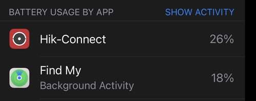

well, it is back to 92%
so if it stayed at 11% it was going to be a win
i give up with them. Put them in a drawer until Apple decides to acknowledge the problem and issue a fix
