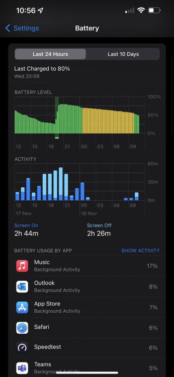

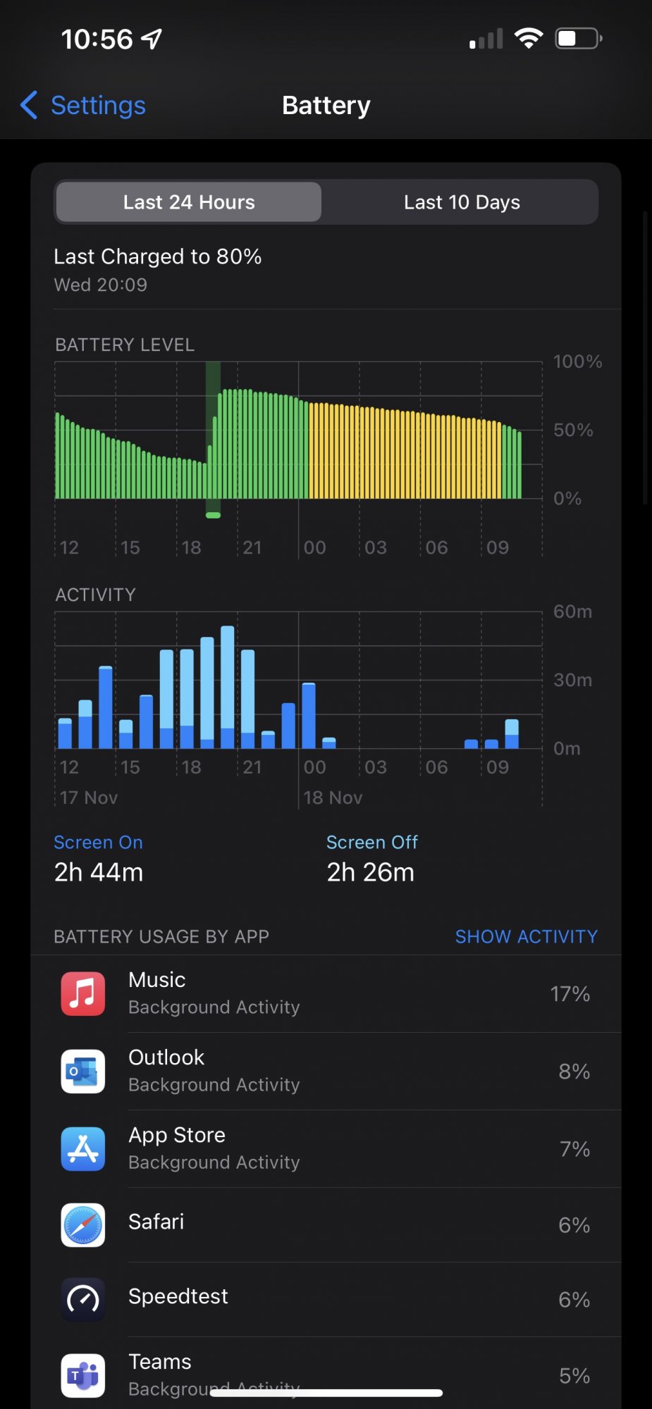

Had Bluetooth off and low power on during sleep.. Still drains a lot. Looks like invisible draining but if you tap on my sleeping period find my is the one drawing power. I have lots of Apple stuff in my home, MacBooks, Homepods, Airpods Pro/Max, Mini, AppleTV, Watch, iPad. Guess some still communicate thru Wifi for Find my.

I would try turning off Find My for when the phone is offline, and put in airplane mode with bluetooth and wifi off. Just for one night to see if it still drains
